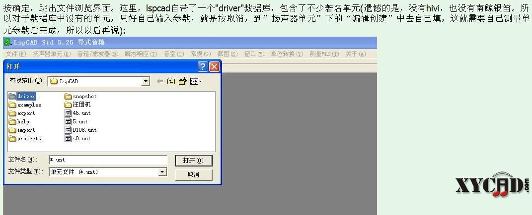

 楼主| 发表于 2008-10-12 09:12 | 显示全部楼层

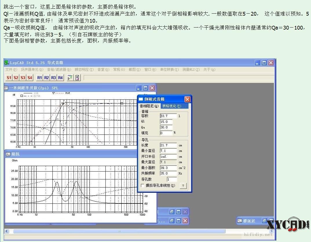

[localimg=1071,434]1[/localimg]

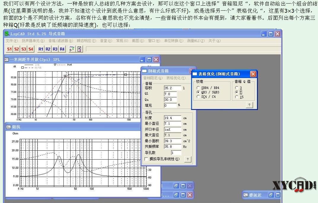

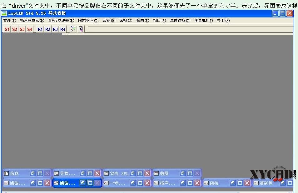

[localimg=1053,668]1[/localimg]

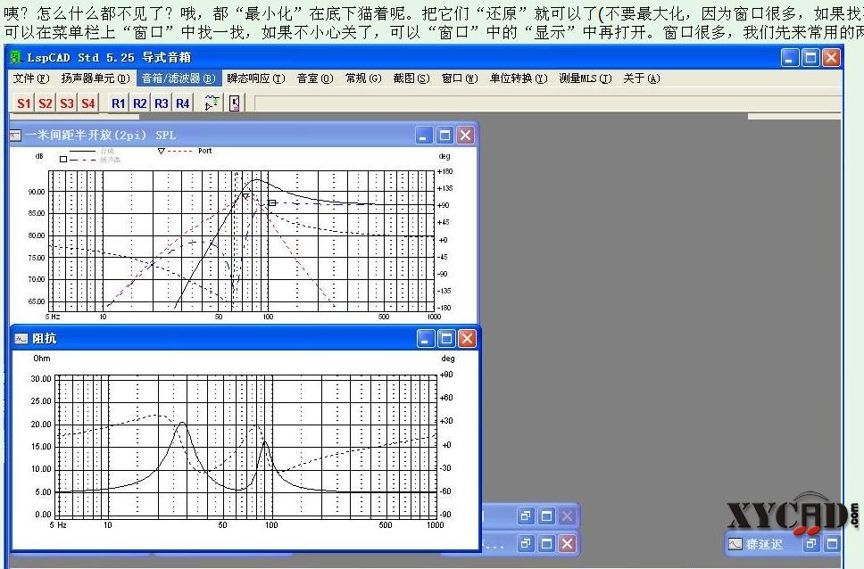

[localimg=1074,835]2[/localimg]

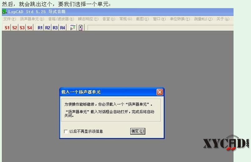

[localimg=1073,687]3[/localimg]
 楼主| 发表于 2008-10-12 09:13 | 显示全部楼层

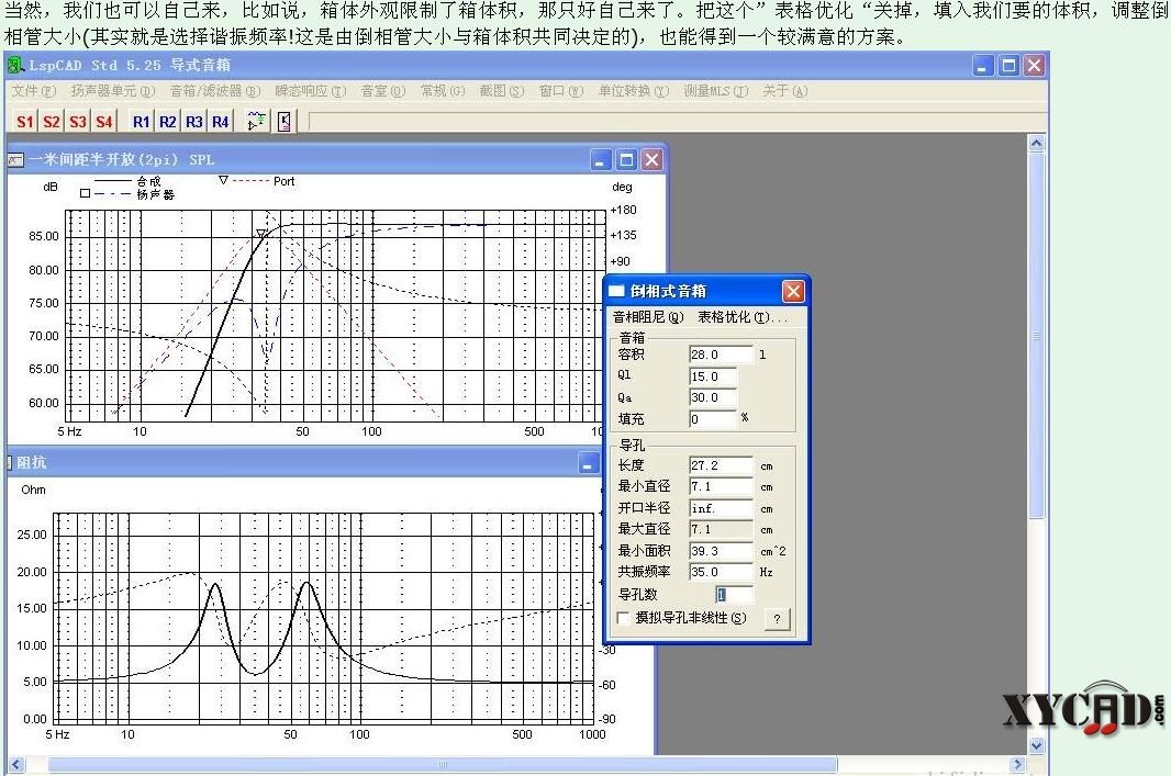

[localimg=1066,707]1[/localimg]
